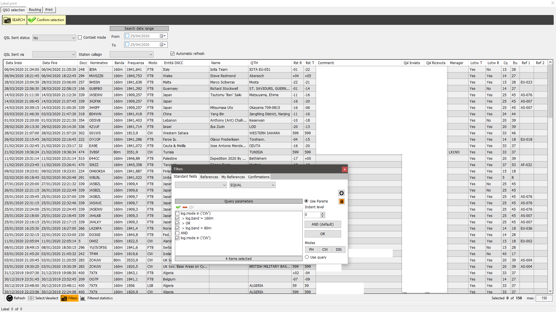

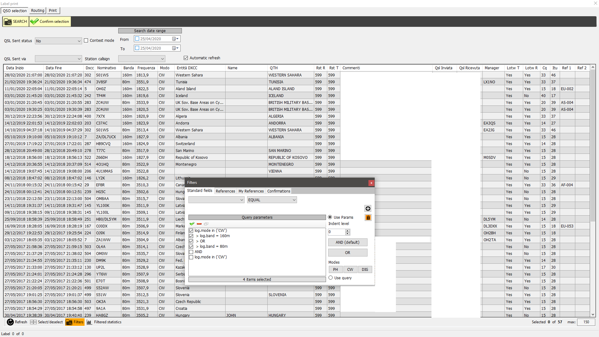

Error: (I tried and confirmed it while using the QSL Manager and the Label print filters) A specific ordering of the params doesn't filter correctly while doing a query, while standard SQL queries do what is expected to happen even by changing the order of the properly indented conditional clauses.

But when I tried to do the same exact thing with the params and the indentation levels (see the two screenshots below) if I tried to do it with the "mode" param set AFTER the OR condition the table would show me all the QSOs made in 160m or 80m ignoring the mode parameter, while if put at the beginning (as first parameter) the query works well. I also tried to switch from the "log.mode in ('CW')" to "log.mode = CW" and to insert the ANDs manually but the error persists.
