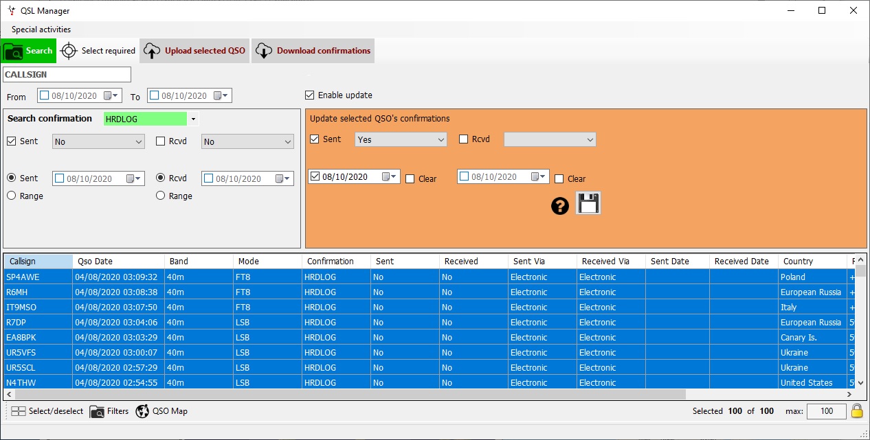

QSL Manger to update sent status (Click the floppy disk to save changes)

These QSO'S have apparently already been uploaded so the status will not get changed that's why I said to manually update
