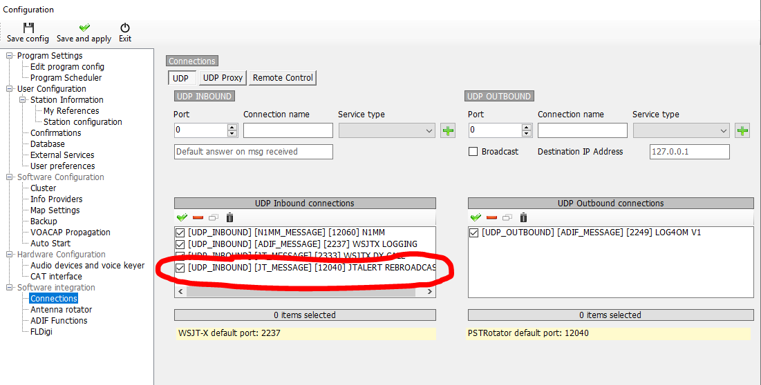

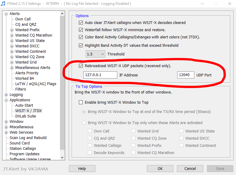

All who are having trouble getting the DX Call info from WSJTx or JTDX to populate the Callsign field in Log4OM V2...
Try closing JTAlert, then retry. If the call sign from WSJTx or JTDX then populates the callsign field, then JTAlert is blocking the UDP message.
Cure:
1. Set up in JTAlert (either version for WSJTx or JTDX) to Rebroadcast the UDP messages as follows...Settings, Applications - WSKT-X/JTDX:
2. Create an additional connection in Log4OM V2 - Configurations, Connections - as follows.
With that additional connection, the DX Call transfer should work with or without JTAlert running.
Let us know if that helps.

Doug, thanks for the recommendation, it worked for me even with JtAlert opened, but the QSO logged twice on Log4OM...any idea of what can be the reason?, I already have the Inbound connection for the Adif File.

Santiago,
The post I made describes how to get the DX Call feature from WSJTx or JTDX to work when JTAlert is running.
If you are double logging, then you likely are logging directly from WSJTx and possibly have Log4OM V2 set to scan the wsjtx.adi file. Just turn off logging from either one of those and that should solve the issue.
Doug
W7DRM
