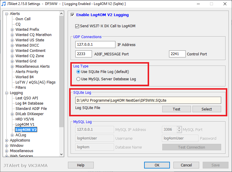

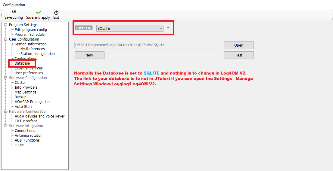

First of all, you don´t have to uninstall the older version of JTalert. If you install over the fly all settings
are o.k. in the new installed. If you uninstall you have to do a full new setup of JTalert. I see that you
reporting a "MYSql error" .... Did you use a MySQL database in Log4OM V2 or do you use the standard
SQlite ? If you use SQlite you have to disable the MySQL in JTalert and you have to insert the path of
your SQlite database. By the way, in my screenshot you see Port 2233 for ADIF message but this was
changed by me so i´ve had the 2233 used since the first JTalert beta was given by Laurie to our Alpha
Team. Normally using standard 2236 in JTa and L4O should work to0.

If you have not used MySql in Log4OM you have to do nothing. When installing normally all is set
to use SQlite. You have only to change in JTalert but if the setup window will not open there it
could be another problem. But it´s JTalert problem and not Log4OM. If this is reported by other
JTalert users on Lauries site i think he will be fix this. But you can try a fresh installation of JTa
so it could be possible that you have only a corrupt installation.
