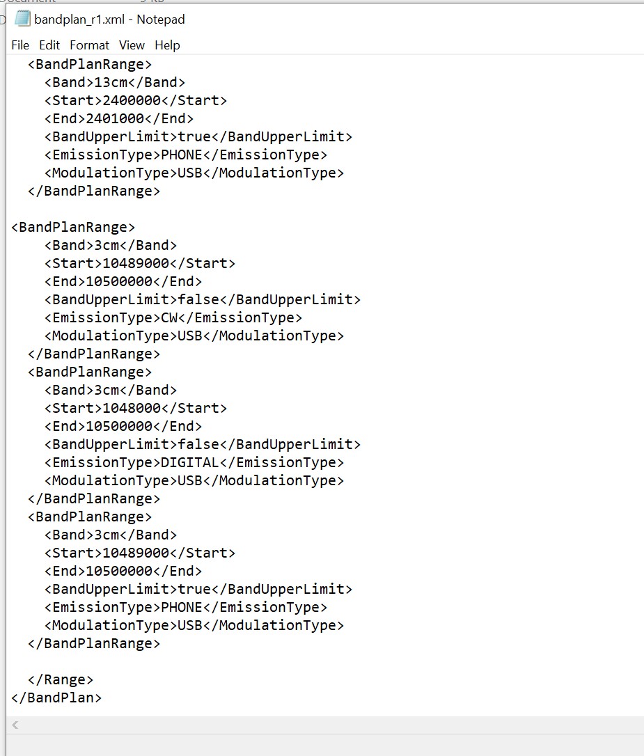

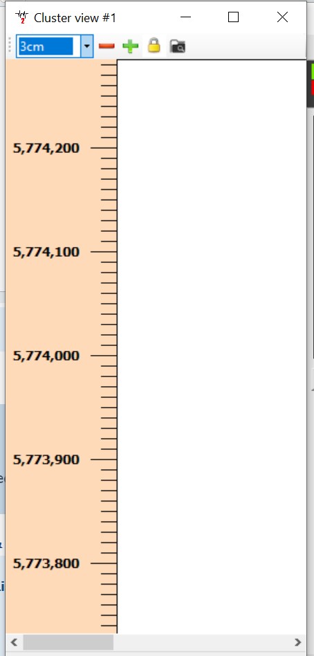

I am reviving this post with a question. My 3cm cluster band view shows some interesting frequency values. I checked the configuration of my bands/frequencies in bandplan_r1.xml file and they seem okay. Can anyone tell me why is the band cluster view for 3cm showing these weird frequencies values?
