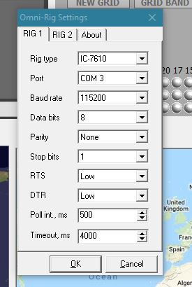

Herve,
this is my setting for 7610, it's the same of my old 7600:

Terry, I have no problems with my 7610. Omnirig and log4om v2 work great for me. Mine was an advice to Eric because for my 7610 (except the baud) I use the same settings that I used for my 7600G4POP wrote: ↑07 Feb 2020, 00:13 But are you sure the radio Baud rate is set to 115200 and that the CAT control is set to either USB or ACC according to what you are using.
