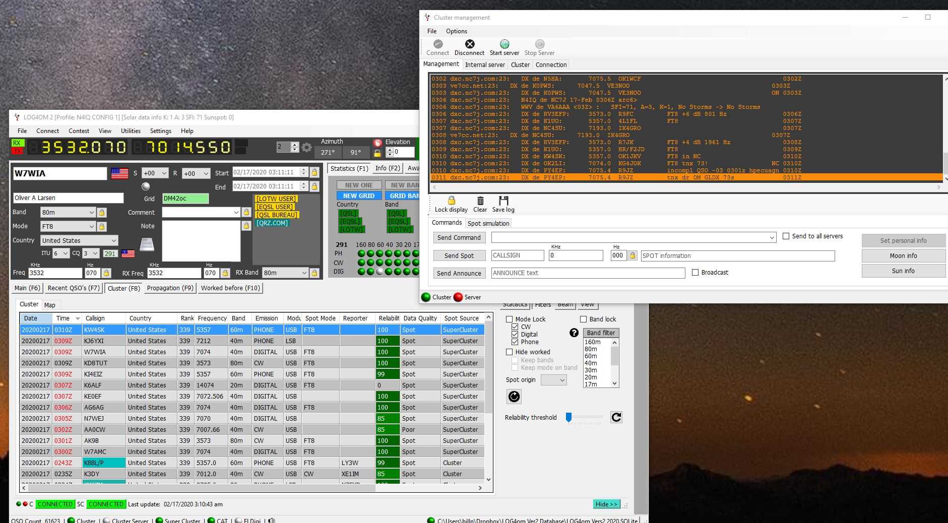

Attached is a screen shot.
I have all filters to default (none). Beam is set to all, SP and LP. Cluster configuration in Settings are the default ones - Grouped cluster and stable clusters.
I am receiving a lot of telnet spots in the manager, but many are not showing in the cluster window. Many of these spots in the manager are ones I am interested pursuing - i.e. HR/F2JD spotted by K1UO at 0309Z. It and many other spots never appear in the main cluster window even though my filtering is turned off.
I saw some similar spot questions in the forum but none exactly like this. All these manager spots are current spots but many are but not showing. I know it must be something I am doing, but what?
I notice a lot of the times are in RED - what does this mean?
Thanks in advance - bill N4iQ

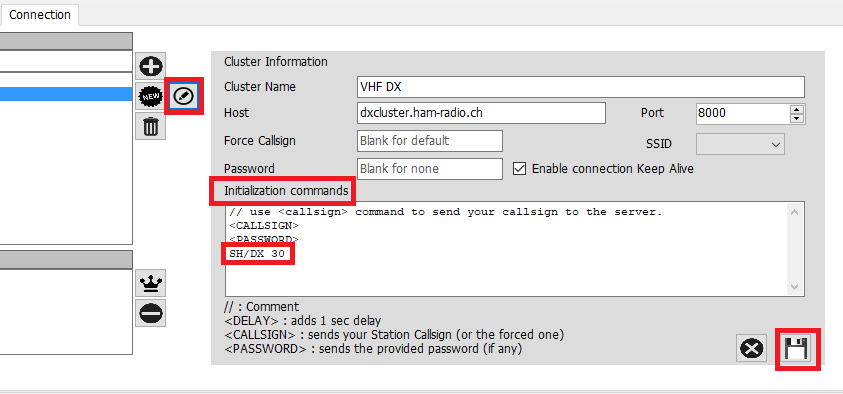

Hello WO2X,
please open the Telnet window and disconnect from clusters. Now hit the "Connection" Tab. If done a
window will be open up which having 2 lists on the left. The list below showing the clusters you have
normally active if connected. Find all these servers in the list above and hit the edit button (one after
the other). Edit is the pencil sign beside the "New" button.
If you have done you can change the initial commands at the right side. Normally we have a SH/DX 30
in but you can change also to your Show/DX. Don´t forget to save the changes with the disquette symbol
below the commands list. Do this for all clusters you have in the active cluster list. Then restart Log4OM
and check the result.
