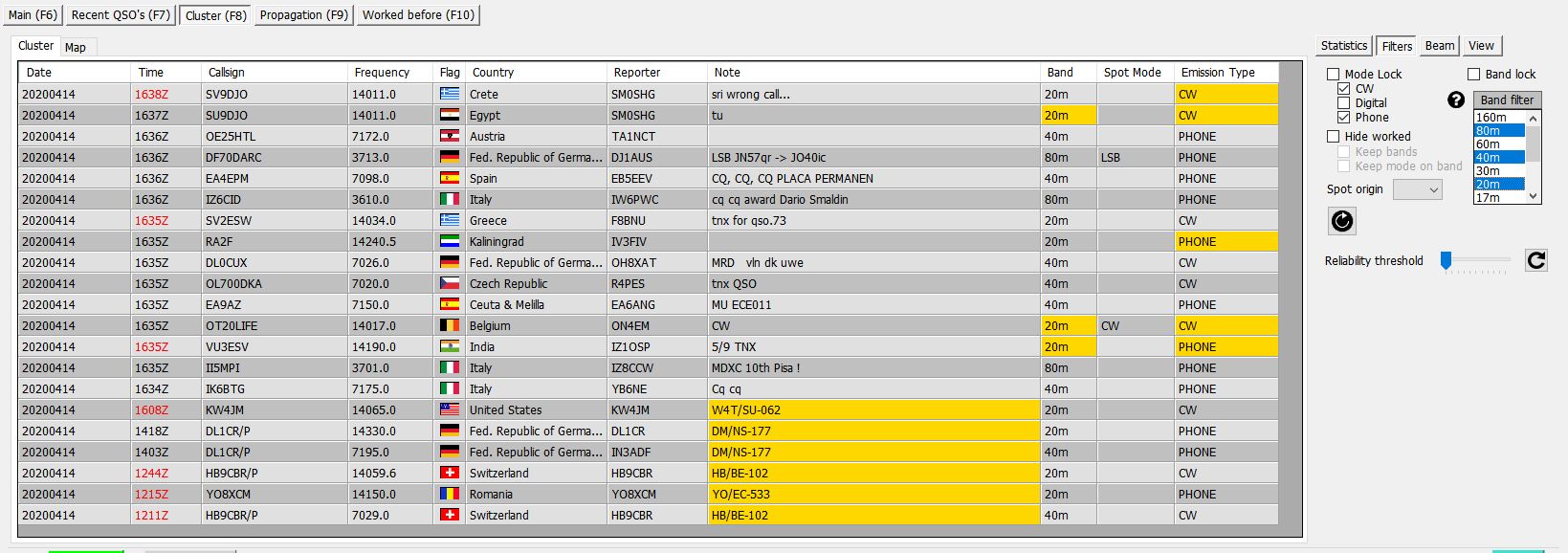

G4POP wrote: 14 Apr 2020, 14:32 Use a combination of the mode and band filters in log4om
Terry,
can you please explain how to?
Can you make an example? I want to filter 10136.
Tks
Max IU4JNR
Posts: 11605
Re: How to filter (exclude) specific frequencies
Something like this
