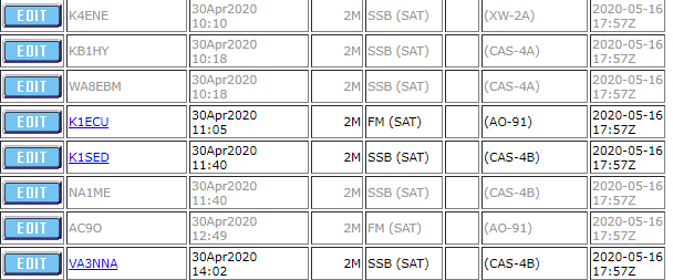

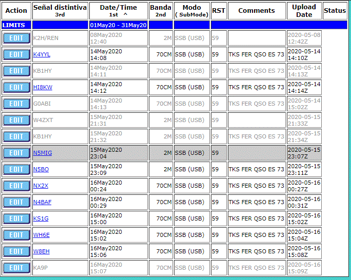

I am having the exact same issue. eQSL website does not show the QSOs as Satellite. I have created a new post to my concern today here. I am new to this Log40M world. I am using the latest Log40M software. I configured it per the user guide and even watched the latest videos by Terry / G4POP which are excellent. I am also noticing that LotW website, although Log40M uploads without any errors, the QSOs are not found!
QSOs uploaded automatically by Log40M:
I've just uploaded some QSOs to eQSL and LotW using TQSL softare. Notice the Sat entry:
This is how the main Log40M GUI looks when entering a call sign;
Luckly, I only have about 15 entries using Log40M. Until I can see a fix, I can't continue to use it since the other person is expecting a confirmation of the QSO
Rafael / NN3RP

I've been testing the manual upload by exporting the ADIF with only the needed entries. These are the entries that make the eQSL website to show corrent qso for me, YMMV:
# Log4OM 2 by IW3HMH version 2.6.1.0
# http://www.log4om.com
# created: Sunday, May 17, 2020
<ADIF_VERS:5>3.1.0 <PROGRAMID:7>Log4OM2 <PROGRAMVERSION:7>2.6.1.0 <eoh>
<BAND:4>70cm
<CALL:6>KK4YEL
<MODE:3>SSB
<QSO_DATE:8>
20200517
<SAT_MODE:2>VU
<SAT_NAME:5>RS-44
<TIME_ON:6>005245
<PROP_MODE:3>SAT
<APP_L4ONG_SATELLITE_QSO:1>Y
<EOR>
