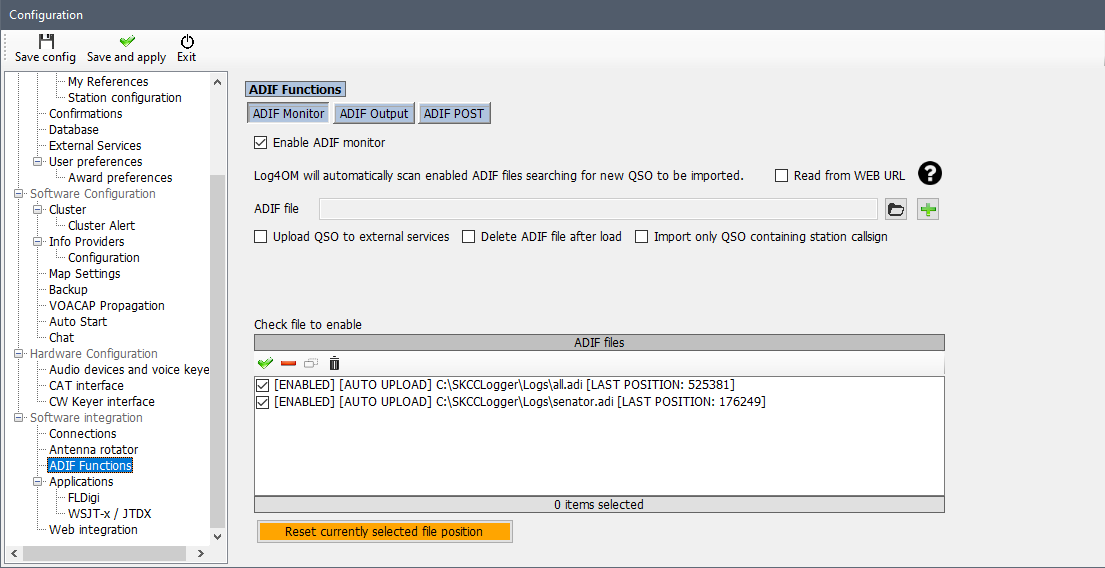

I don't think there's a way, but I use the ADIF monitor function in Log4OM to watch SKCC Logger ADIF updates. When I work an SKCC station, I use SKCC Logger to log the contact and Log4OM imports it automatically.
I use com0com software to allow both Log4OM and SKCC Logger access to the CAT port at the same time. This gives me all the features of SKCC Logger and the convenience of not having to manually import into my master log.
