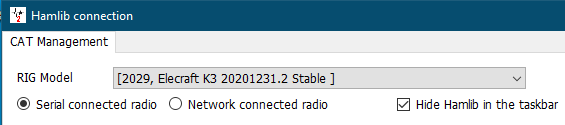

> 4.0 Seems work fine...replaced the hamlib_riglist.csv with the attached.
Done that but Log4OM is still calling radio ID 229 (Elecraft K3)
Hamlib 4.0 new radio ID for K3 is 2029.
How do I make Log4OM using the new hamlib_riglist.csv?
73, Markus HB9BRJ

Thanks Mike, but Log4OM still thinks my K3 is rig 229:

Re: Hamlib 4.0
Hamlib 4.1 win64 working fine now.
Forgot to re-select my rig in Log4OM's Connect > CAT > Show CAT interface screen:
73, Markus HB9BRJ
73, Markus HB9BRJ
