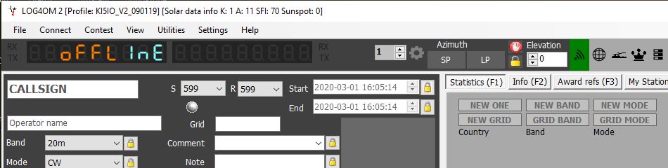

Regarding the small rig selection box at the top center of the main Log4OM V2 screen (just left of the gear symbol), is very hard to see. It selects rig 1 or 2, but the number is black and the background is dark grey. More contrast between the number and the background color would be helpful.
I suggest making the background color white or light grey.

Good input, but might also be related to one's monitor and associated video drivers. I'm just mentioning that as a possibility.
I've attached a screen clip of my Rig Selection box and (at least for me) it is quite viewable.
Take a look at the Elevation selection box which could approximate what you are suggesting. One of the differences in the Rig Selection box (for now) is that the character font is 'bolded' so it tends to stand out a bit more now.
Will certainly put on our consideration list for cosmetic tweaks.

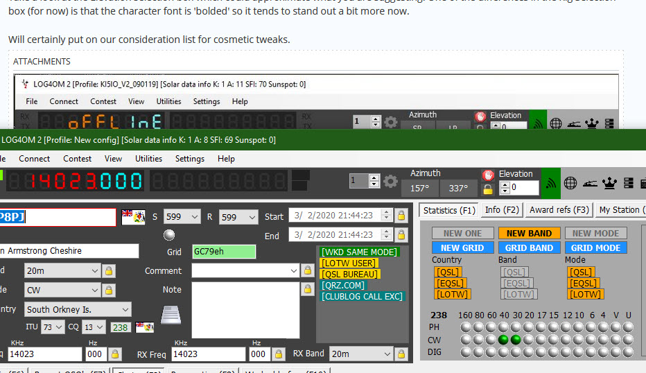

Nolan,KI5IO wrote: 01 Mar 2020, 16:11
When I saw your screenshot I thought yours was much more visible than mine. I would not think monitor would come into play as its a screen shot but certainly would not rule out video drivers.
Below is a screenshot of my Log4OM over the top of your screenshot. Oddly all our colors seem to be very similar but the rig selection box certainly is different. I don't use it as I have switched to HamLib to get some benefits that OmniRig wont provide but I can see where it would be harder to read for some that others.
Darn computers !
Rich
