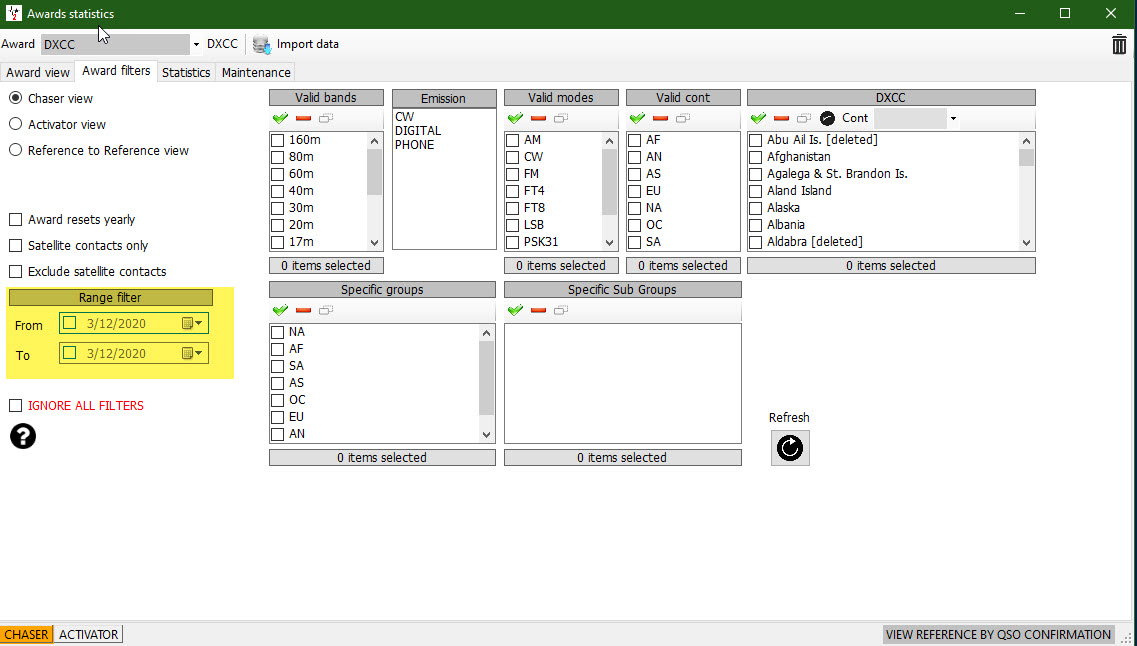

KR8T wrote: 12 Mar 2020, 17:50 Can we have a date range added to the filters, so we can see what DX/band/mode is needed within that date range? For instance, I'd like to Work DXCC each year. This is somewhat implemented in the contest mode already, so perhaps those fields could be brought out to the filter panel.
Also, a second request, when restricting what Band the Cluster shows, could we have a range to select from, for instance 20m through 10m?
Thanks for the great logging program.
Rick
KR8T
As you have been informed already the date range is already available in the awards
Your second request about cluster band selection is also available using the normal windows selection method's of ….
1. Holding down the shift key wile selecting a range of items
2. Holding down the Ctrl key while selecting individual items
So hold down the Ctrl key and then click on the 20m band and while continuing to hold down the ctrl key select additional bands
When you see a question mark in the software hover over it with your mouse to see hints and tips, had you done so in the cluster filter the above would have been explained.
The user guide is a good source of information as are the YouTube tutorials
