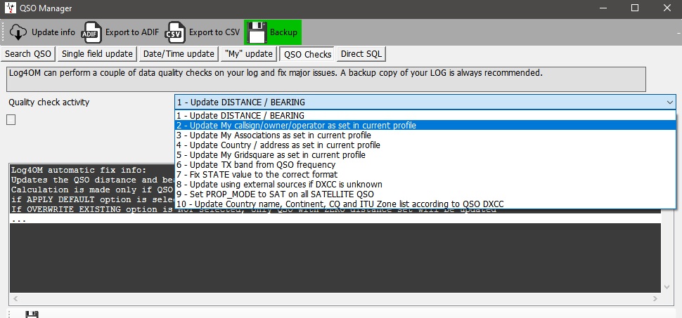

You can update that information in the QSO manager as shown below and other QSO manager tabs. Just filter first then bulk update
Adding that feature to import will slow imports down considerably, especially with large databases
