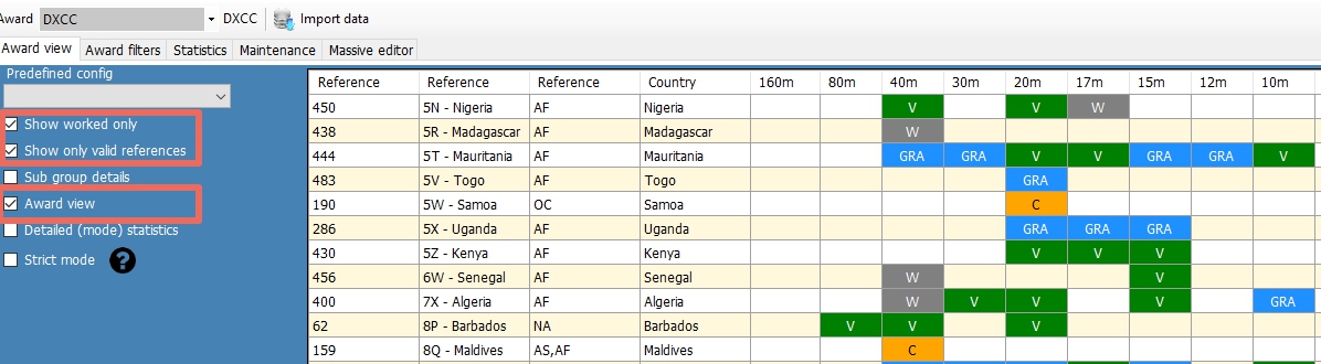

I think the best way to proceed is to use the DXCC Award Status (View -> Award status - DXCC). Make sure your settings are similar to mine on the screenshot:
DXCC - Award Status.jpg (216.07 KiB) Viewed 4376 times
Having checked "Show worked only" will show you all the 113 DXCC entities your currently worked. Boxes marked in blue (GRA) mean, that this band slot has been confirmed and granted by ARRL. Boxes in green (V) mean, that you have this confirmed in LoTW, but you have not applied for this contact. Boxes in orange (C) mean, that this contact has been confirmed by QSL card, but you have not validated this contact with a DXCC Card Checker. Boxes in grey (W) mean, this band slot has been worked, but you have not received any confirmation.

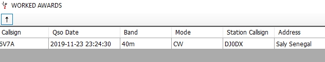

Clicking on any box will show you all the valid QSOs for this band slot. E.g. on the screenshot above I have worked Senegal on 40m, but have not received a confirmation yet. Clicking on the box will show all contacts, e.g.
DXCC - 6V 40m Worked.jpg (33.97 KiB) Viewed 4376 times
You can see that I have worked 6V7A on 40m, but it's not confirmed yet.
You easily can see all the 9 countries you have worked, but have not received confirmation.
If you want to see all countries not worked at all, remove the tick from "Show worked only". But, from my point of view, it's more useful to use the cluster. Any new/unworked DXCC entity will be color coded (see the manual for more details).
