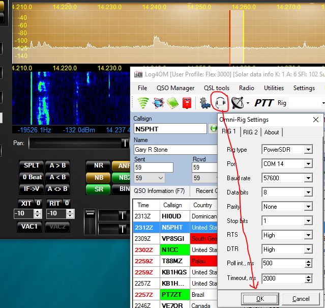

After some time, hour or maybe less. It seems when double clicking on cluster to change band/freq only the mode ssb/cw will change not the freq or band. To fix it , I have to open omnirig settings and click ok (see photo below) and then it works like it should.

You have found the work around for this issue! Others have reported it in this thread - viewtopic.php?f=7&t=2073 but only some of us have this issue. I have reported this in our Mantis bug tracking system. Hopefully Daniele can find the cause.

I have also noticed every time you hit save anywhere in the Log4OM the omnirig and Log4om disconnect. Just clicking on the headphones and ok. Will get you going again. FYI.. THIS seems not transceiver specific.

Thanks for posting this - your workaround is easier than mine (restart everything! - SmartSDR and Log4OM).

Glad I could help some get by having to reset the whole program. Two simple clicks seems to get around this issue. ;) ;)
