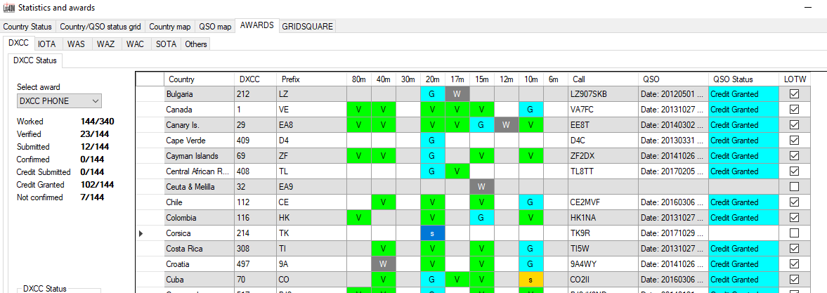

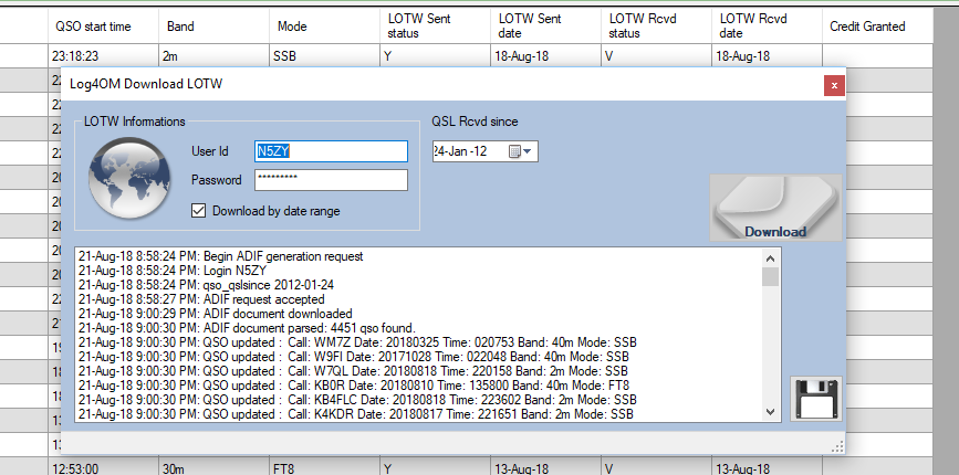

In this image you can see that the numbers are off.
2018-08-21 LoTW Download.png (64.12 KiB) Viewed 7562 times
Here is the download..
2018-08-21 DXCC-ShouldBeGranted.png (52.81 KiB) Viewed 7561 times

Today I downloaded a couple new LoTW QSL's that were confirmed but still nothing for the DXCC confirmed. I can only assume there is an If/Then in Log4OM somewhere that is not giving an expected result.. since it imports from LoTW but doesn't change the database.
I guess I will need to go line-by-line through the DXCC download and manually change them in the Log4OM gui.
2018-08-21 LoTW Download in Log4OM-QSLignored.png (90.01 KiB) Viewed 7545 times
