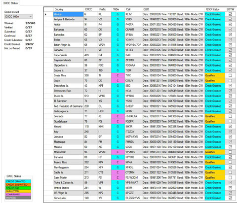

Probably not anywhere near as good as DXWin
Utilities/statistics and awards
Award DXCC tab
Select award e.g. Mixed
At the bottom - Worked only
At the bottom 'Actions/validated QSO's/suggest QSO's for submission'
At the bottom 'Export/All QSO's
Now you can export those QSO's for submission to ADIF or CSV for submission
See images below

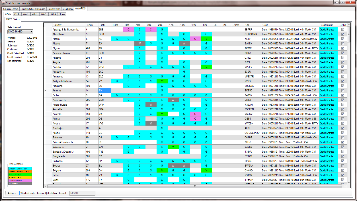

Ok, first let's talk about what you suggested - it appears to work differently for me, and I'm not sure why. When I proceed through the steps you describe, my list includes all (?) of my QSO's with credit already Granted. Example attached. Included in the list are countries which have no new QSL's to submit (e.g. Aland Is., Algeria, etc.) Those are already granted and marked as such. If I understand the submission process using Log4ME, LoTW QSO's are automatically "Validated" once they are matched by both stations ("confirmed" from LoTW). That's fine. On QSL's, upon receiving one, I mark it such, and Log4ME marks it as "Confirmed." Now it will need to be submitted to a card checker (or the ARRL). So, now I would expect the list to only include suggested QSLs for submission. Note that none of them indicate a QSO to use. Clearly, I've got something incorrect in my database, or I'm doing something wrong. Once we get by this one, I'll ask you about submitting multiple Bands & Modes in a single submission, etc. Thanks, Terry.
73, Duane
73, Duane
- DXCC QSO Selection.png (170.5 KiB) Viewed 6968 times

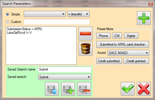

Here is the method which I use to prepare a "submit" list to ARRL for card checking. I think that is what you are requesting.
1. When I receive a QSL card I open up that QSO's Update QSO window, QSL information tab, and mark the Received status as Yes, and the date received and Received via information. If I know that QSL was a new country (entity) confirmation, or new band or mode, I also check the Submitted to Card Checker checkbox. This becomes my que to submit that QSO to ARRL for credit.
You can also go through the Awards and Statistics/DXCC grid for bands or modes and find QSO's which have been confirmed with a purple C grid, open that QSO and use the Submit to Card Checker view to change the status of those qso's to Submit. This is likely where you need to start, as you probably have not been marking them as submitted when received as above.
2. When you are ready to export a list of these cards to submit to ARRL, then use QSO Archive facility to search "SubmissionStatus = ARRL" and LotwQslRcvd != V". This will select only those records which you have marked for submission, AND those QSO's which have not subsequently been Validated by LotW. You can save that search for future use. I have mine saved as "Submit". Here is my search which I have saved: 3. Order the list by callsign or country as you wish by clicking on the appropriate column heading. Select all records, then select the "Export only standard ADIF fields" and the "ADIF version 3X" options. Now you have a file which you can use to order your cards, and upload to the ARRL website.
Page 126 of the Log4OM users manual describes a similar method for creating this export list, but I find it more complicated and less intuitive.
I hope this helps.
Doug - W7DRM

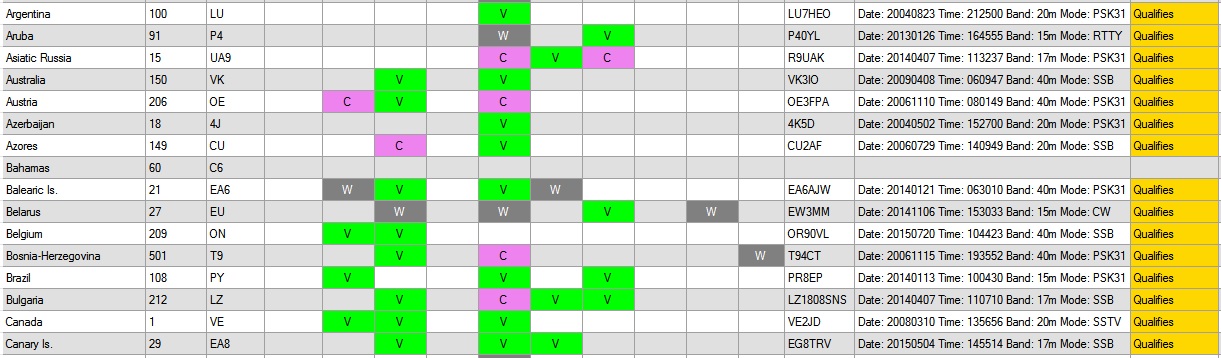

I received the support request and your SQLite database!
I believe there was something wrong with the data that you imported and of course without being in possession of that ADIF I cannot see what it was!
However I did the following:
1. I exported your complete logbook as an ADIF 3.0 from Log4OM (File/Export ADIF and select ADIF version 3)
2. I created a new database and then imported the Log4OM ADIF (File/New Database)
3. I restarted Log4OM
This procedure was to ensure that I had a properly formatted ADIF version 3 (Older ADIF versions don't support Credit Granted status correctly)
The result was as shown below so I suggest you do the same
