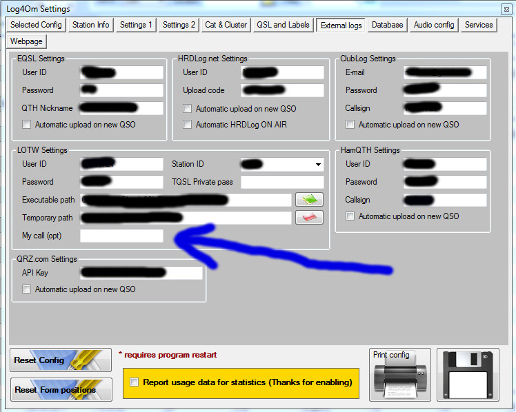

MU0WLV
Posts: 2
Joined: 17 Apr 2017, 10:10
Re: LoTW - confirmed download problem
Post by MU0WLV »
Hi Terry
Thank you so much for your super quick reply... i have checked the PWD and when i hit the download it only finds my previous 2U call QSO's
So - i know its me thats messing up - did some more digging around and noticed i had added my 2U call to "My call (opt)" in the settings thinking this was where i would put a previous call.... not so - DOH! putting my 2U here made the download limit just the 2U qso's to be downloaded
Sorry for wasting your time.
Thanks again!!
