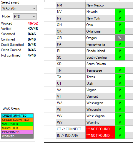

I think I'm going crazy and cannot imagine what I've done. Starting on 12/12/17, when a QSO verification is downloaded from LoTW, the state field of the QSO record is being changed. This is a little hard to explain but the State field was IN before the verification download from LoTW and after the field contains IN // INDIANA. I am running JTAlert and WSJT-X and the original log record comes from JTAlert. This has been working beautifully and the log records that are created by JTAlert look just fine until a download from LoTW.
To test this a little further, I went into QSL Management and downloaded from LoTW going back one additional day to 12/11/17 and now, by George, all of my verifications from 12/11/17 on have the state field goofed up.
Here is what my 20m WAS status looks like
The county field has the same thing happening to it. If I log into LoTW and look at QSO detail, all of the state and county names look like this. I've never looked at that information before so i don't know if that is normal or a newly added "feature".
Anyway, does anybody else have this same trouble or is it just me? If just me, there must be something I have changed that would cause this odd behavior but I don't know what it is.

I thought I had done something terribly wrong... I've been closely tracking my stats pages as I'm nearing WAS on 40m and 20m... and suddenly was like.. 59 of 59 states worked? whaaa? .... didn't know if its eqsl (don't 'download' that very often) or lotw... but popped up tonight. My guess is that lotw changed their adif file?...
