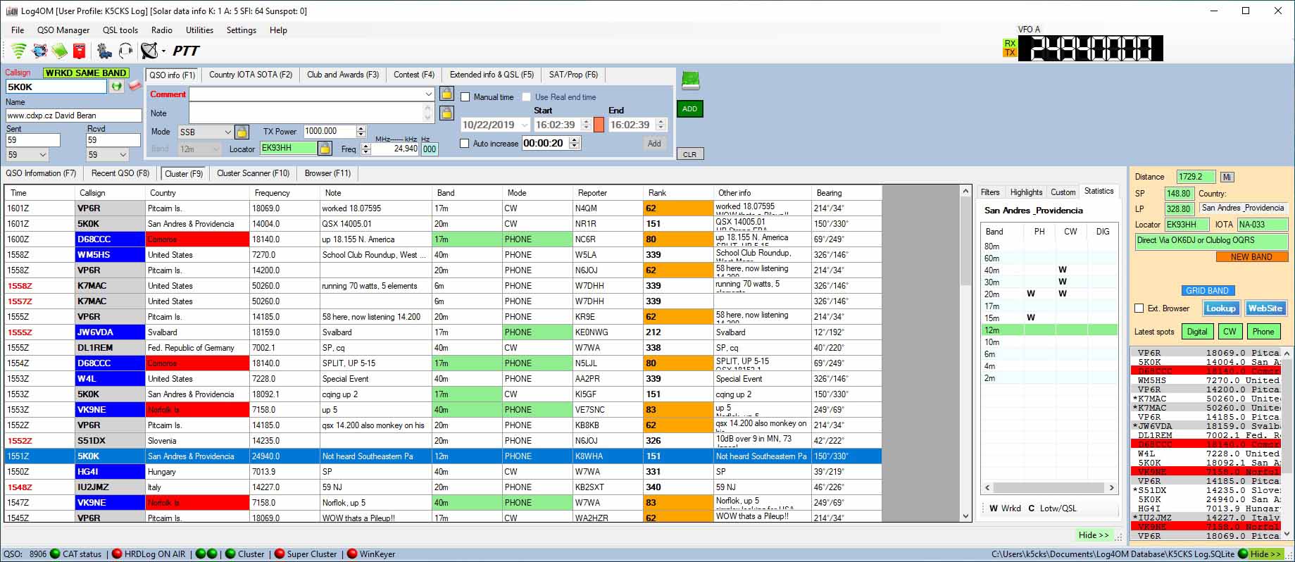

Just for example... Here is a screen shot. I have 5K0K cued up in the Callsign and selected (blue highlight) in the Cluster window. On the right I have selected the Statistics tab and it is showing that I have worked him on 40, 30, twice on 20 and once on 15. But if you look above his callsign (in red) it says I have "WRKD SAME BAND". If I look at my QSO Archive I have worked him before on 12M CW. But that is not shown in the Statistics window. Thanks for the help Terry!

No the statistics window is showing that you have worked the same country not the same call sign on those bands and modes.
When you look at the old qso for 5KOK what country does it say?
Re: Statistics Display problem
It says San Andres & Providencia. I think this is not what I thought it was under the Statistics tab. I thought that this was the Statistics for the specific callsign. This would be very useful because it would tell me at a glance if I need to work him on the Band and Mode he was spotted on. Right now the only way to tell is if I do a search in the Archive. Is this something that will maybe change in Ver 2?

I think that you will find the spelling of the country in the old qso does not correspond to the country name according to DXCC please check country name in the log4om input display against that recorded for the old qso. Maybe it was imported from another program?K5CKS wrote: 22 Oct 2019, 16:46 It says San Andres & Providencia. I think this is not what I thought it was under the Statistics tab. I thought that this was the Statistics for the specific callsign. This would be very useful because it would tell me at a glance if I need to work him on the Band and Mode he was spotted on. Right now the only way to tell is if I do a search in the Archive. Is this something that will maybe change in Ver 2?
