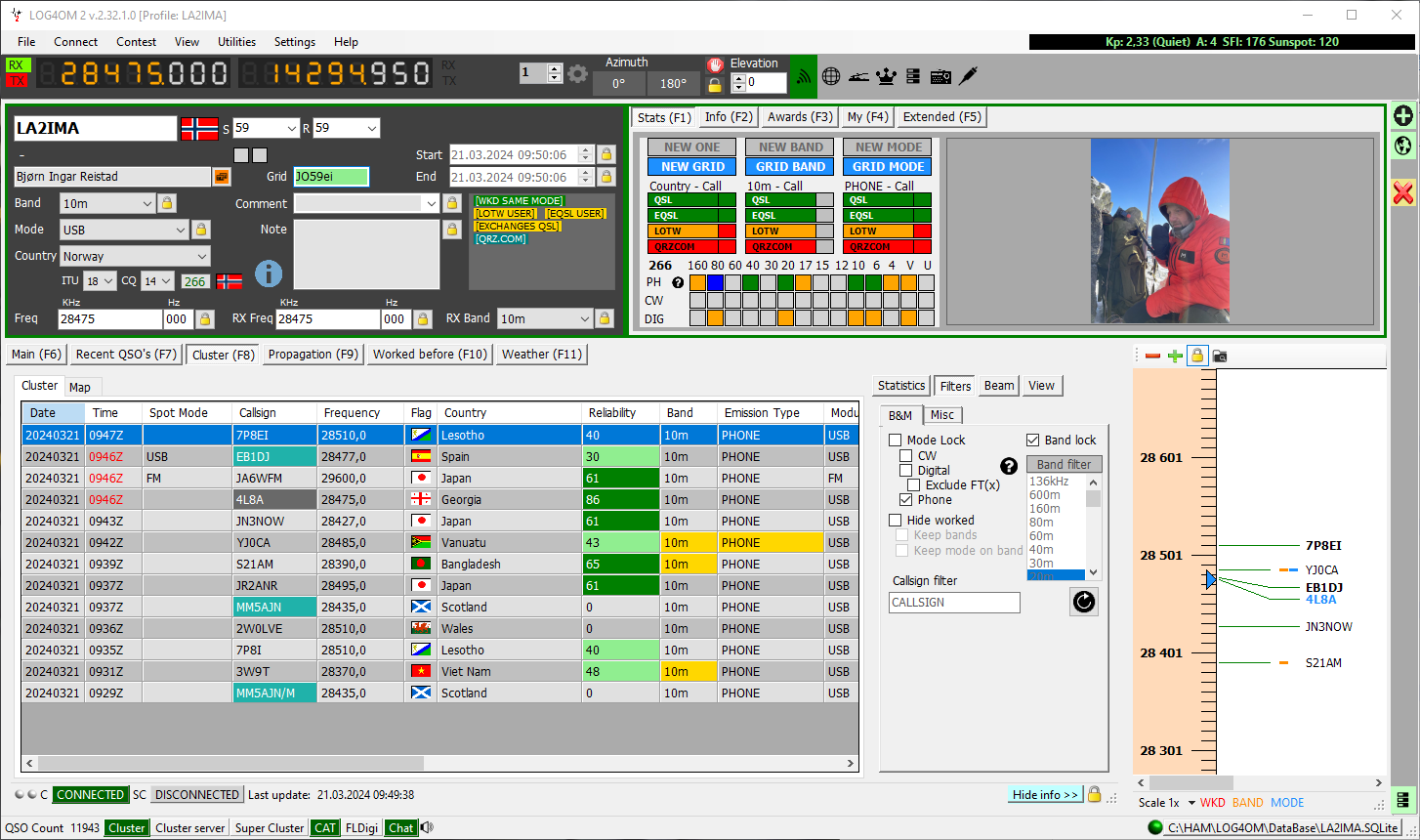

Hamlib is working, but switches the radio between VFO A and VFO B continously...
Downgraded to fw V2.10 on IC-7700, same issue.
Tried RigExpert TI-5 interface and Omnirig, same issue.
Can you please explain why the correct frequency shows at the top of my screen, but not in freq-field in the logger?
For me, it looks like the logger get the frequency, but do not populate the freq-field.
Both inside the LOG4OM, so it gets both VFO A and B.
I have used this interface on my IC-7600 and on this PC, until one week ago, worked without problems for many years.
I'm still suspicious about the Omirig ini-file. That's the only change, I've done.

I did not found a solution, but VFO A up and working...
Downgraded to LOG4OM V.2.29.0.0, Omnirig 1.20 w/IC-7700.ini (that came with the installation).
The "Freq" and "RX Freq" populates, but only with VFO A, do not register split or VFO B. "Band" is also populated correct.
We have a Clubstation with the same setup as I've got at home, and the problem started there aswell when we did an upgrade to V2.31.0.0.
Date of upgrade 13 March 2024.
The IC-7700V2.ini don't work.
73 Bjørn LA2IMA
