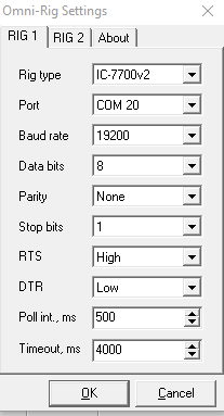

IC-7700 fw V2.20
MicroHAM microkeyer II
Windows 10
Omnirig 1.2 (use IC-7700v2 rig)

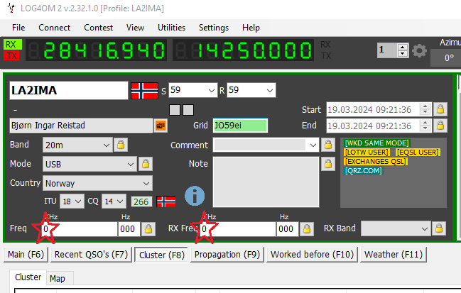

I see the VFO A/B on top of screen, but will not populate in log.
Mode is working, "On air" ok, but "0" in freq field.

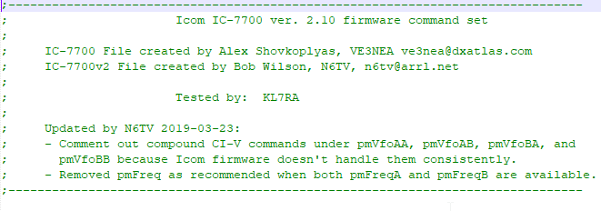

I'm suspecting IC-7700V2.INI, the rig file in Omnirig. Just downloaded the newest rig-file from dxatlas.com.

Please, take a look at the attached image. The problem is in the red stars..

Tried N1MM Contest Logger, no problems. Not using Omnirig in the config. I'm suspicious about the IC-7700V2.ini file. It may have issues with IC-7700 fw 2.2.... just my thoughts...
