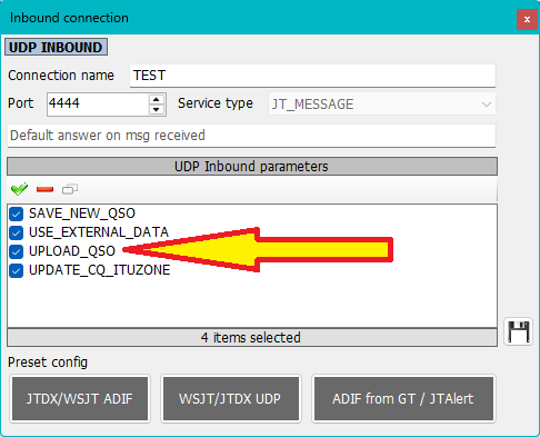

I am using v2.32.1.0 LOG4OM2 and I hadn't worked FT8 in a while.
QSOs on SSB upload to QRZ.com automatically...and that works great as usual.
However, I made a couple of QSOs on FT8 and they did not upload. I thought it was a glitch on my part and made a SSB QSO on 6m and then subsequently an FT8 QSO and no upload of FT8 again. WSJT-X uploads fine to LOG4OM2 - I can see the QSO in the list. Scratching my head on this one.

When I upgraded from my older to this version of LOG4OM2, the setting did not come along for the ride from the previous version.
I'll make a note to check it for the next version. Thanks!!!!
