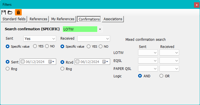

In filters/confirmations?

Hi Terry. Not looking for confirmation of the QSL. Looking for a way to filter on the Awards Submitted and/or Granted under the Awards Ref. tab.
