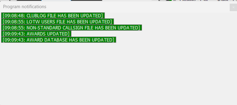

I tried it again. The notification popup screen shows that the award database has been updated.
After this, I shut down Log4OM and run it again. No luck, still an awfull lot of references when I put my own (Dutch) call in the call field.

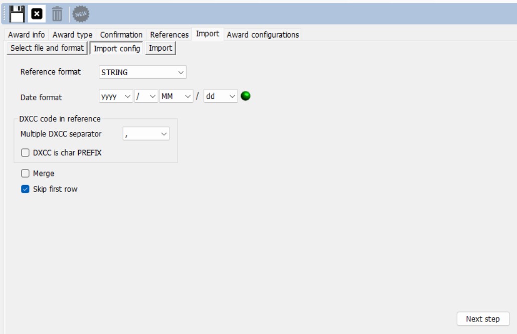

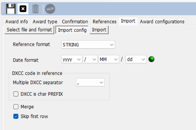

I imported the .csv file again without the option "DXX is char PREFIX" checked. That seemed to do the trick. Now the references are linked to a DXCC.
The import took a fraction of the time then before with the option checked. I really don't know what the option means or what it's for.

Allright, I'll try to write up a "how-to" for updating the POTA references............

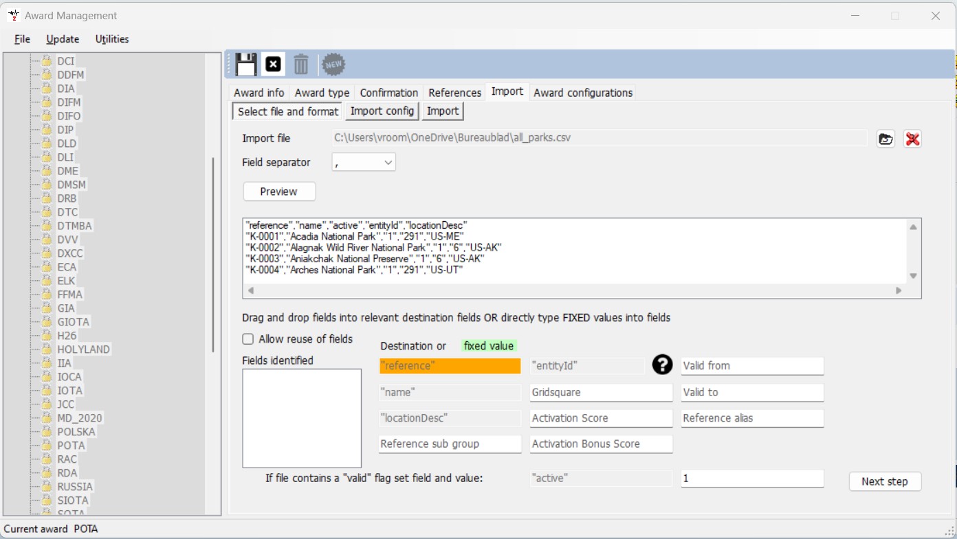

1: Go to "Utilities" ---> "Award manager".
2: Double-click "POTA" in the list on the left.
3: Copy the download URL: "https://pota.app/all_parks.csv" and paste in your browser to download the file. Save it on an easy to find location on your computer (e.g. Desktop).
4: Still in the "Award manager", click the tap "Import".
5: Select the file and click "Preview".

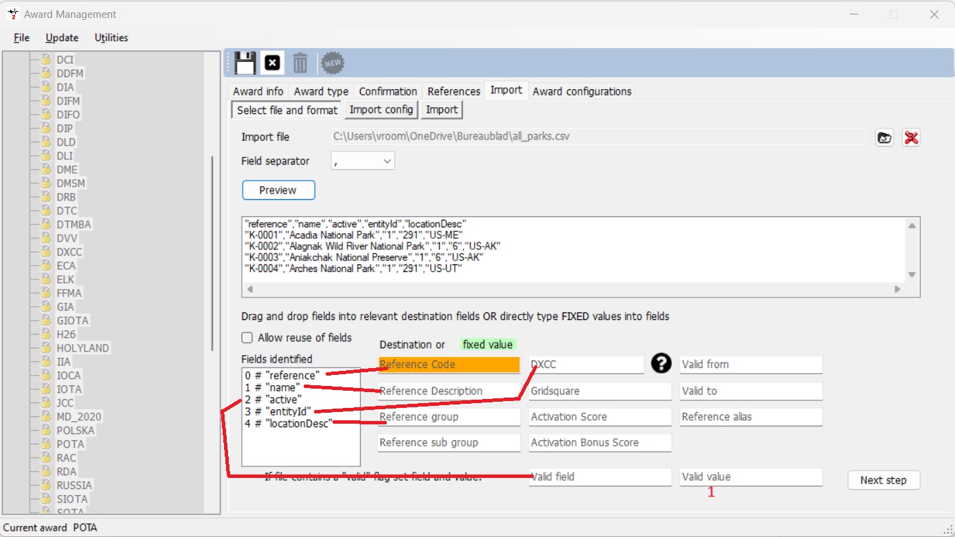

6: drag the identified fields into their corresponding destination, see screenshot below: 6b: It should look like this now (see below). If it does, click "Next Step". 7: In the "Import config" subtab, make sure everything is set like the screenshot below, then click "Next Step": 8: Click on the "Import award" button. The green bar progresses and in the end you will get a pop-up message.
9: Save the award by clicking on the save button, or discard the imported references by clicking the cross.
That's it, your done.......
(Log4OM team, if I missed something, please correct me or delete this post. I'm just trying to help others, not trying to get in the way of things here......!)

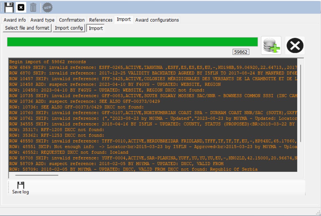

I appreciate your guide for the POTA's. I am trying to do the same thing for WWFF. I have ticked the DXCC is char PREFIX and Skip first row box's. The import seems to be taking a long time and is saying "DXCC not found" on every row. I hope you can help me with this.

Make sure to drag the DXCC field into the DXCC destination on the "select file and format" subtab.
I've got "DXCC is char PREFIX" checked and also "Skip first row" same as you mentioned. (DXCC is a different format in the POTA file, hence the difference I guess)
30 errors in the import log maximum......

I left it running over night and just checked it now. It looked ok but I thought I would redo it just in case. It took about 2mins and looks much better. Also here is the download link for the WWFF .csv file : https://wwff.co/wwff-data/wwff_directory.csv

Can't be right. It took 30sec tops here first time and with a maximum of 30 errors. Wonder what's going wrong there then.
I've used the same downloadlink, copied from the award manager like Terry pointed out.
