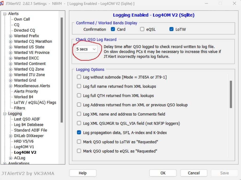

In the JTAlret main window, go to Settings - Manage Settings - Logging. Under "Check QSO Log Record", increase the time until you find what works for you. In my case, 5 seconds works fine. You might need a longer time.
73.
Jim N6VH
Logging Timing.jpg (166.63 KiB) Viewed 1772 times
