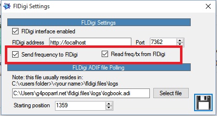

Posts: 11582
Re: Fldigi not changes freq. due to Growl "error network 201"
The Growl error has nothing to do with your issue the errors are there because either you don't have Growl installed or growl has not been configured
Did you check the two boxes in the communicator as shown below?
Post by DK6WK »
tnx Terry: That was my mistake. I checked the settings once more and "send to FLDigi" was not enabled :oops:
