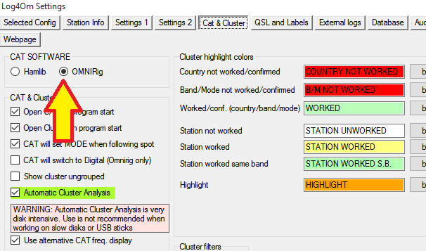

In your Log4OM options/cat & Cluster tab select Omnirig as your CAT software and click the save (Floppy) icon
Ensure that Omnirig is installed

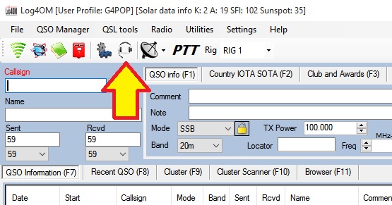

Restart Log4OM and click the CAT button
untitled 2.jpg (68.36 KiB) Viewed 4492 times

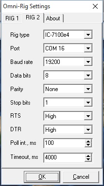

Select the settings as shown below but for rig 1 in your situation - I have my IC7600 as rig 1 and the IC7100 as rig 2
untitled 3.jpg (30.32 KiB) Viewed 4492 times
Click OK
Providing your radio is connected to the computer and the radio is turned on you should now see the following
