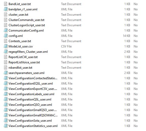

We have been saving a copy of the config file for Log4om and the communicator for some months, check the backup folder or wherever you selected to save backup files in the options.
The zip files contain all necessary user configuration and set up files and of course we backup an ADIF file of your logbook to the same folder. All zip and ADIF files are identified by a date and time stamp to enable the user to identify the latest backups
This is the contents of one of my backup zip files, notice the config.xml
Juergen is correct the procedure is to overwrite the newly installed config files in the roaming/logom folder either with the ones saved earlier or the last config backup file or all of the files in the backup zip file to restore completely including user defined cluster and band plans etc.
