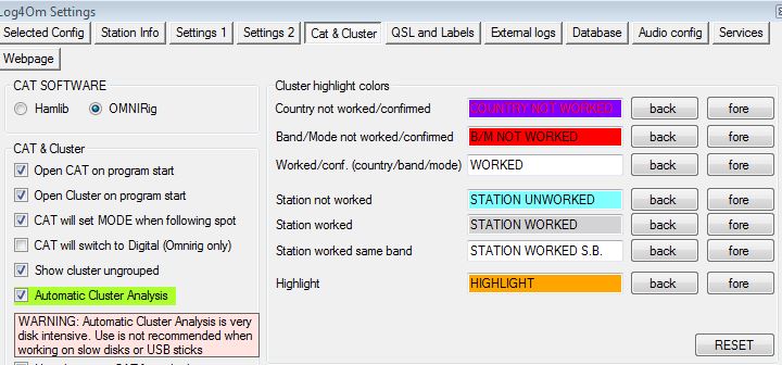

When I worked recently in the AN400* competition I missed the feature to see straightforward if I had worked this station already on the same band and the same mode.
It would be nice to get another button in the Cat & Cluster settings (Cluster highlight colors section) to mark "STATION WORKED S. B. and SAME MODE". This would help very much in such competitions to avoid dupes. It is much harder to look through all the QSO details of a worked station to get the needed information.
Station worked same band AND SAME MODE
- LOG4OM-mode.JPG (65.66 KiB) Viewed 5229 times
73 Olaf DK2LO

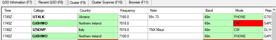

You can readily see in the cluster if the station was worked on the same mode, see my example below where I have worked GI0HWO on 40 meters phone but not CW - Phone is Green (Worked) CW is Red (Not worked)

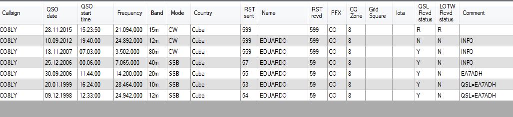

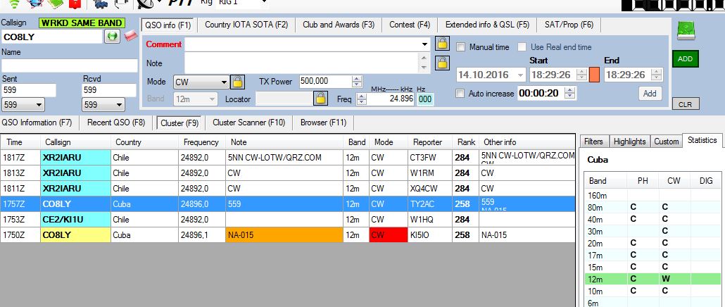

I think this problem is more sophisticated. Your example does not refer to the station worked but to the country confirmed on this band/mode.
Here is an example:
I have worked CO8LY on 12 m CW but this contact and Cuba at all is still not confirmed on 12m. The last issue is the reason why the MODE shows up in red. If I would rely on this information I will make a dupe with CO8LY.
I need the information about the worked-status for the station and not the confirm-status for the country.
Here is an example:
73 Olaf DK2LO
