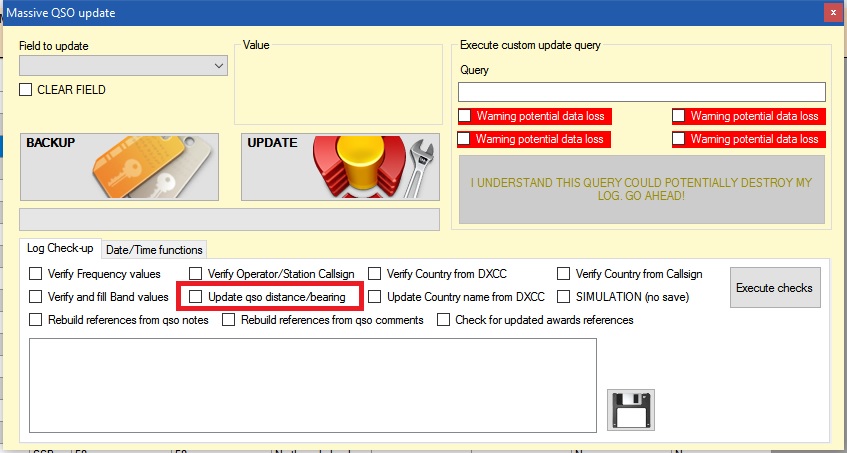

Just imported CQ WW CW log into my Log4OM log. But the Azimuth and Distance columns were not filled in when I did a bulk update info for the imported records.
Back in June I asked a question about updating a field( grid sq) and got the below reply. So I tried this method again on Ant Azimuth and Distance, but it didn't work. Any hints on what I am missing or failing to do?
Tnx & 73 Paul

QSO Archive Manager - Field update
kc2nyu
Posts: 61
Joined: 06 Apr 2016, 20:51
Re: Updating Ant Azimuth & Distance Columns
Post by kc2nyu »
Terry - thank you very much- I must be blind in not seeing that. One more question, my distance appears to be in kilometers. How do I change to miles? ( I did search the User Guide before asking but couldn't find , honest :)
73 & thank You
Paul
kc2nyu
Posts: 11594
Distance can be displayed in the F8 window in miles but is always logged in KM due to the ADIF standard
