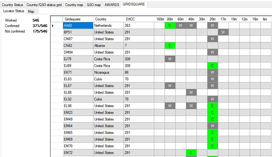

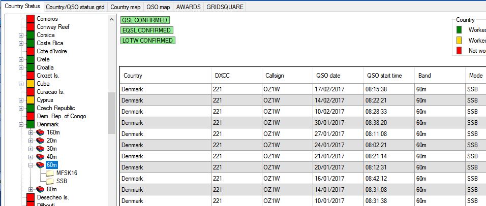

Despite numerous 60m QSOs in my log, the 60m band is missing:
- in the Country/QSO status grid
- in the GRIDSQUARE matrix
- in the AWARDS > DXCC status matrix
- numerous other pages in Statistics and awards.
Any ideas?

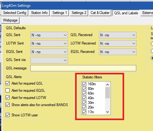

HB9BRJ wrote:Despite numerous 60m QSOs in my log, the 60m band is missing:
Did you check it in the statistics filters list?
......the 60m band is missing:
It's not for me!

Have completely ignored "Statistic filters" on the "QSL and labels" settings tab. Seems I should take time and go through all settings...
Problem solved, thank you Terry!
