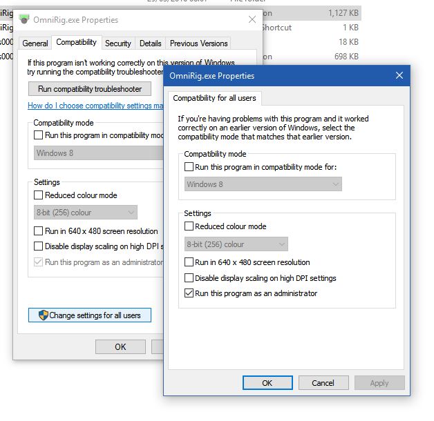

Also ensure that Omnirig is running as an administrator
C:\Program Files (x86)\Afreet\Omnirig and right click on the Omnirig.exe file and select 'Properties'
Then in the 'Compatibility' tab click the button 'Change settings for all users'
Check the box 'Run this program as an administrator'
Click 'Apply' then keep clicking the 'OK' buttons to close the windows down
Restart Log4OM
Restart Log4OM

BRILLIANT. Thanks Juergen and Pop.
Its easy when you know how!
Problem solved in less than 10 seconds thanks to utter clarity of response from Terry.
