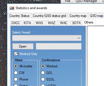

Although I have just conducted Settings > Awards Database > Download Updates, and then restarted Log4OM, my Utilities > Statistics and Awards > Others < Select Award drop-down list is empty. I assume that there should be a folder of .XML files somewhere that provides the parameters for the different awards and that the list would be drawn from that repository. The only thing I've found is an AppData/Roaming/Log4OM/AwardsLastUpdate.txt file with a timestamp matching the Download Updates request. Regardless, my Other Awards dropdown list is unpopulated.
I've not used the Log4OM awards features in the two years I've been a Log4OM user (I've tracked my WAS, WAC, DXCC, and WAZ separately), but have recently suspected I may have completed a WAJA since I have ~800 JA QSO's logged.
Outside of removing Log4OM from my Win10Pro64 machine and reinstalling, is there a trick to restoring the Other Awards list? I'm running Version 1.30.0.0.

Nope, no such file is present. Only the required awards.xml file, which contains the definitions for the DXCC, WAS, et al, conventional awards. The "Others" drop down remains empty.
I have also run the Clear Custom Awards Database command under Settings > Awards Database. No change; no Others listed.
Running the Awards Update does produce the "Confirm AWARDS update download" window and creates a AwardsLastUpdate.txt file (which contains those "Other" awards), but it still doesn't allow the program to display them in the drop down list.
