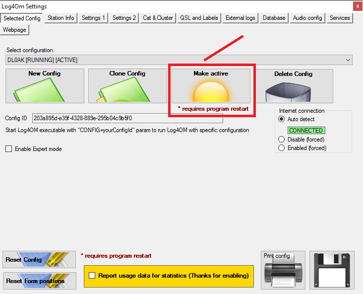

But think it is easier to create a new config and a new database for your Special Event Call.
Don´t forget to make this new config active ....
