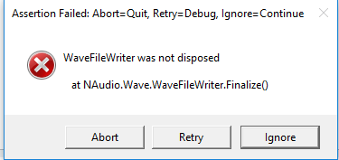

Hi Rich. I got mine working and recording now but as stated previously one can nor record over a previously recorded message. Hopefully this gets fixed. Bottom error screen print.
As far as me being able to record I set my computer sound card mic and speakers to be default and in the Log4OM Audio setup and replaced a bad headset as the mic did not work. Then I set the L4OM program Audio Config to;
L4OM Audio Capture.PNG (22.46 KiB) Viewed 5399 times
L4OM Audio Record over error Capture.PNG (7.97 KiB) Viewed 5399 times

How do you delete the file? I remove the label and it asked me if I want to deleted it and I say Yes. But the recording is still there.
Posts: 11591
Re: Voice Keyer ?
kd0zv wrote: 23 Mar 2018, 22:26 How do you delete the file? I remove the label and it asked me if I want to deleted it and I say Yes. But the recording is still there.
Prety easy realy just delete the files in the audio folder!
C:\Users\YOUR USER NAME\AppData\Roaming\LogOM\audio

kd0zv wrote: 24 Mar 2018, 15:30 OK, was thinking that log4OM did the delete.
Thanks Terry
Rich
It should do but if you study my earlier post I stated that this is an issue that I have asked Lele to rectify, so meanwhile you need to do it manually!
