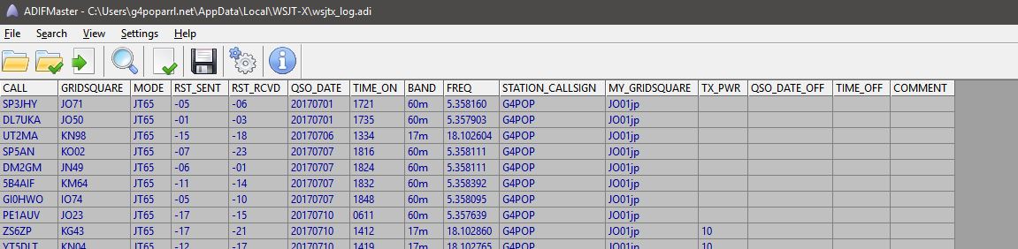

WSJT-X does not record the Clublog status in its ADIF file so there is nothing for Log4OM to import, resulting in empty fields saved to the Log4OM logbook. See the WSJT-X ADIF file below, do you see a Clublog field?
