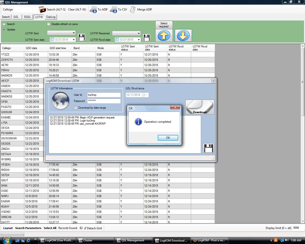

Hi all, im sure this has been covered somewhere before I have searched and found very little to help me, I have been playing with this for a month trying to get the LOTW to download, upload works fine, but when I hit download all I get is the following... Thanks for any help... Art

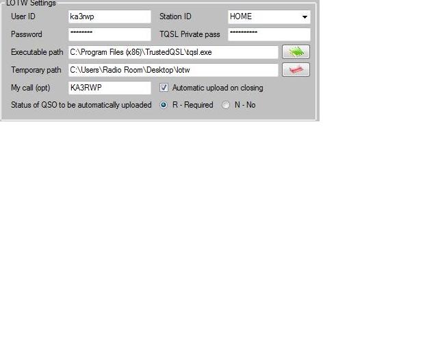

Hi Art,
did you have all correct in the LotW setting in Options/External Logs ?
Station ID must be set and the LotW Password must be the password
that you use for login to the LotW website. The private pass must be
set if you have a password for your certificate.
73´s, Juergen

Password must not contain special characters like
+×÷=/_€£¥₩!@#$%^&*()-'":;,?`~\|<>{}[]♧

Thanks for the quick responce, no special characters in the password, and here is the way I have it set up
Re: LOTW Download
Providing your user name and password are the same ones that you use to logon to the ARRL LOTW website and no special characters or spaces are included it should work fine
It also helps if you state what version of Log4om you are using so that we can test with that version!!!

The download does not involve Tqsl
Tqsl is only used for upload and you already stated that uploading was fine?
