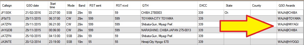

As described on pages 146 and 147 of our user guide these special awards are derived from entries in the QSO Awards field, not from any data retrieved from QRZ etc - See below
These fields are normally completed by the user during the QSO but I guess your expecting them to be completed automatically from the lookup data? This is not the case because that information is not supplied for the ADIF QSO award field by any on line lookup service, its shown in the QTH field - Sometimes!
You could do a bulk edit in the QSO manager, having first selected all QSO entries for Japan, using the search parameters followed by a QSO update, then if your lucky you should have most of the prefectures listed in the QTH field to enable you to identify the correct QSO awards entry
Posts: 11569
Re: Other Awards
Just to prove it works OK if the data is present in the QSO awards field
