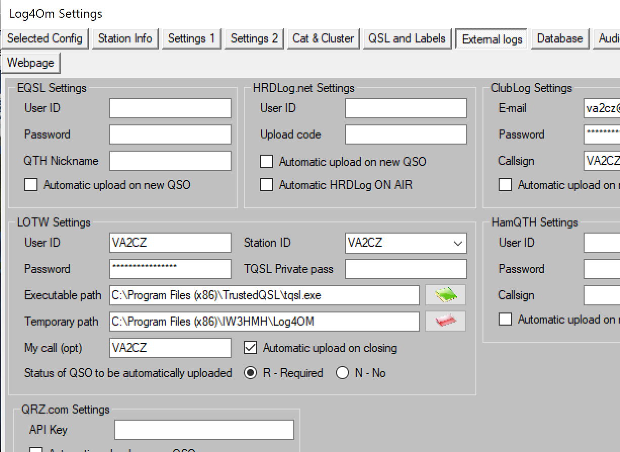

I need help. I've been running around for too long and can't find any explanation for my problem on this forum.
I would like to UPLOAD my log on LOTW automatically but I can't. Here's how I do it. Thank you for helping me...
First:

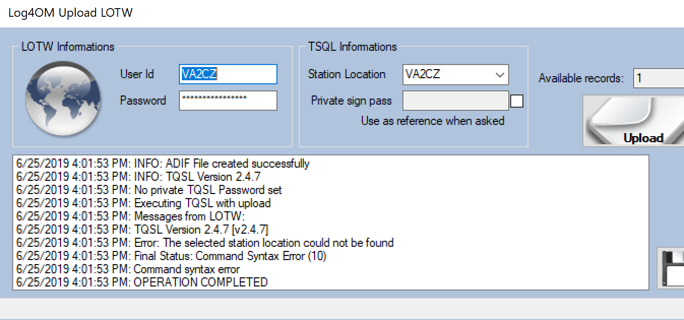

2nd:
Capture d’écran, le 2019-06-25 à 10.32.38.png (99.15 KiB) Viewed 3040 times

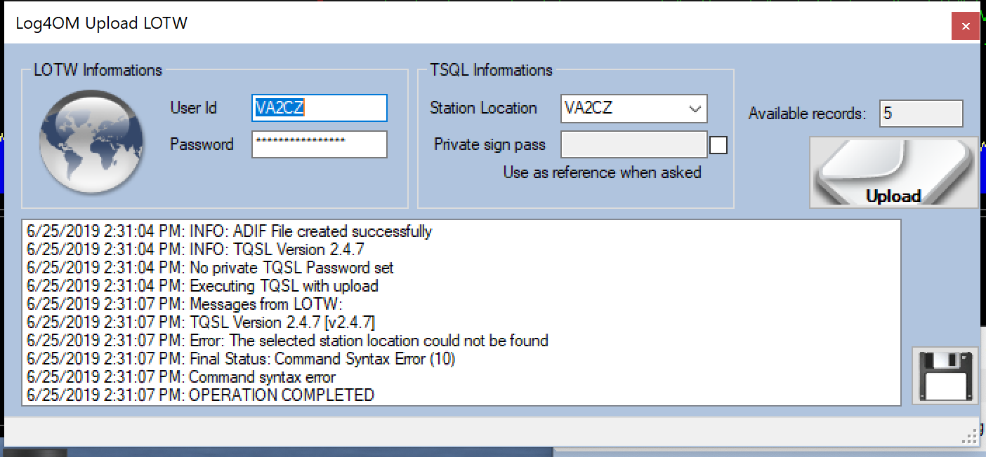

3rd:
Capture d’écran, le 2019-06-25 à 10.31.46.png (124.86 KiB) Viewed 3040 times
I think my problem is with the TEMPORARY PATH, maybe !
Hope to solve this problem soon.

Pierre:
On your TQSL program under station location, you need to enter your location Usually "Home" and you should be ok after you do that.

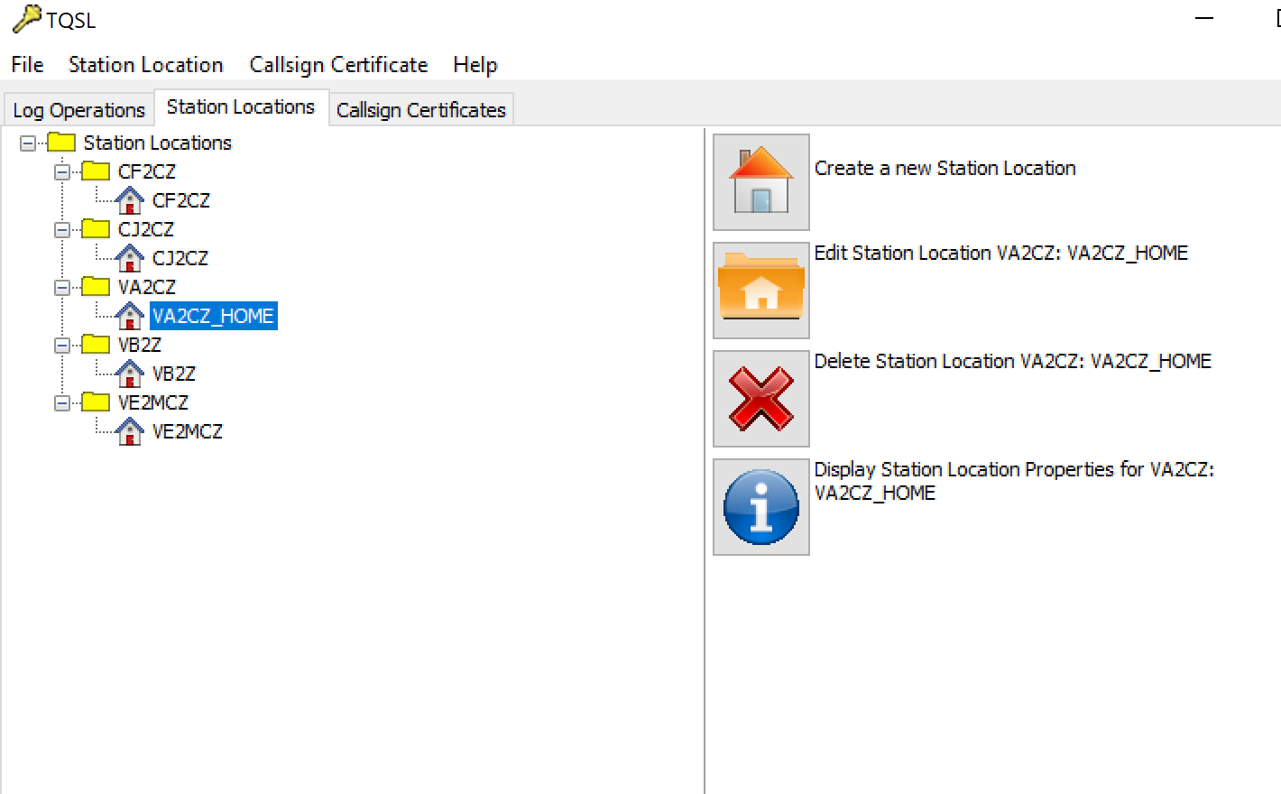

Hi Aldo,
Tnx for quick answer. I change for VA2CZ_HOME and still have the problem
Capture d’écran, le 2019-06-25 à 12.00.37.png (77.17 KiB) Viewed 3030 times
Capture d’écran, le 2019-06-25 à 12.02.13.png (94.33 KiB) Viewed 3030 times
Capture d’écran, le 2019-06-25 à 12.02.43.png (21.1 KiB) Viewed 3030 times

Did you try just home without call sign

it works now !!! Hourra ! Thank you Terry and Aldo !!!
