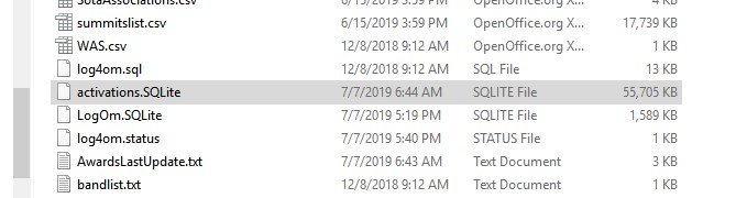

According to your comments about the Roaming folder, I examined the contents there and located my .SQLite file "LogOm.SQLite" (there is no 4 in the name) in the AppData\Roaming dir. This after I imported my own log file backup after again installing the updated Log4OM file as Administrator as another test. This importing of my own backup is what has been required over several years as I didn't know what was going on. Now, I have found the sql file in the Roaming Dir. so we know it resides there. I also manually loaded that SQLite file from Log4OM file menu and it is as it should be - the same as my own backup. So far so good.
There is another file called log4om.sql (not SQLite). It is 13 kB and dated 2018 whereas the proper one is 1.5 MB and has the proper date of today. Don't know if this is significant ...
Now what happens when installing new versions of Log4OM? I did one more install of the latest Log4OM upgrade as Administrator to see what happens to the LogOm.SQLite file. I had the AppData\Roaming directory on-screen so I could watch what happens. After the install the contacts (Recent QSO) tab is again totally empty. Here's the interesting part - the LogOM.SQLite file that had all my contacts was replaced by one that has 20 kB and dated 2018 - it happened before my own eyes! Even loading that 20 kB file produces an empty list of contacts. That is, I guess, the explanation. But, why is this happening?
Please look at the screen shots: files_before (files before re-installation) and files_after files after re-installation).
I am emailing you a log file too as I cannot properly diagnose many interesting things in it. But, we now know that the sql file containing my contacts is being replaced by another smaller empty one by some process.

logom.sql is the base file for MYSQL database creation.
LogOm.sqlite is the EMPTY FILE that Log4OM use to create a new database. It will be renamed and saved with the required name during the "FILE -> NEW" activity
If you save your log in LogOM.SQLite, that is a "system file", you're writing over the application template file, that is fully replaced on every reinstall.
you should not use that file for storing your data, as it's intended to be a clean file for creation of new database. Technically you can create dozens of archives, each one with data for a different callsign...
Simply create a NEW sqlite file somewhere, better not in the roaming folder and definitely not using the template /roaming/logom.sqlite for storing your data.
Best 73

OK now we're getting somewhere! Thanks.IW3HMH wrote: 08 Jul 2019, 13:32 logom.sql is the base file for MYSQL database creation.
I can remember asking about this on the forum in years past and never got this far. I do not know why that name was used for my database. I've been using this since probably 2014 so whatever happened back then, whatever I may have done, has carried forward to this day.
