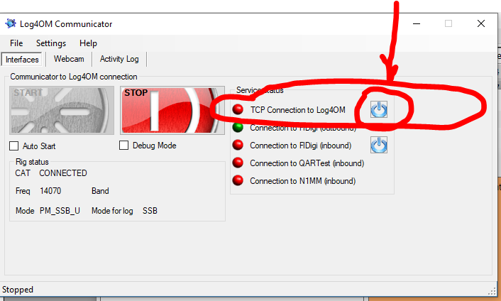

You might try this, when you notice the red light on the comm svcs., and failure to log from wsjtx, open up communicator, and you will likely note that the TCP Connection to Log4OM is red. Press the ON button next to it, and that should reconnect things.
Then minimize, don't close communicator.

Thanks for the speedy reply. As I mentioned in my original email, I opened the Communicator and observed that the TCP connection light was red. I clicked on the button to it's right to start it up and it changed from red to green. However, on the bottom of the LOG4OM screen, The comm Services light is still red. I have an option to connect TCP. f I do that, I get a message stating that TCP was already running. If I proceed, I get a new 2nd instance of the Communicator which I do not want. I cannot log from WSJT-X.
