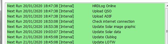

Re: Not uploading QSO's
This is a view from the diagnotic form, it says HRDLog online, but it's not, and no qso's are uploaded.
OK let's see if we can resolve this because it's all, with the exception of HRDLog on line which is a known issue, working fine for all of our Alpha team.
