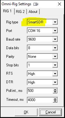

HB9VQQ wrote: 22 Jan 2020, 09:25
Can you explain ? What CAT Info is currently missing with the Omni-Rig implementaion of Flex SmartSDR ?
I would think that would work as long as you have a serial port setup in Smart SDR for port 16.
I am running the same setup except with a baud rate of 19200.
Rich
kd0zv
HB9VQQ

Re: Transceiver Control Interface
Post by HB9VQQ »
Rich, absolutely, that's the nice thing about SmartSDR, just configure a new CAT Port in SmartSDR CAT or re-use an existing one which is not already in use by another application. Done.
