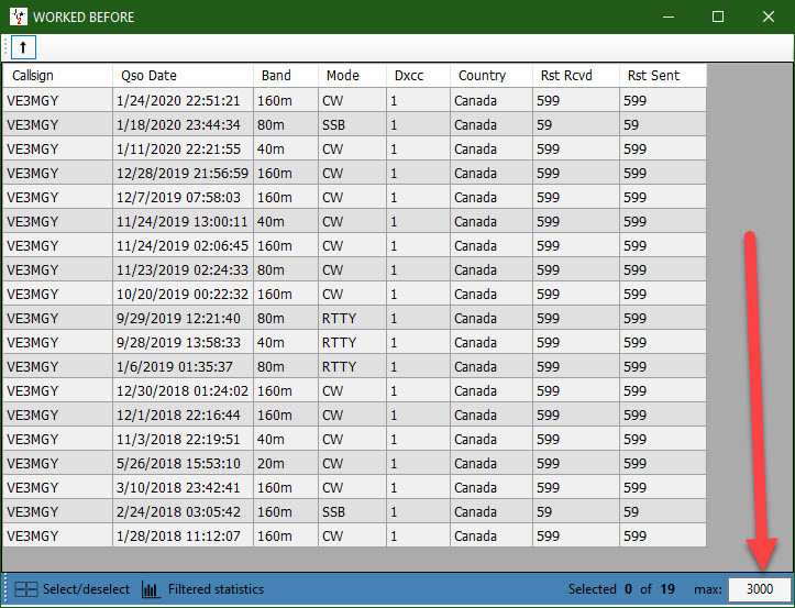

Worked before window
So on the worked before window there is a number on bottom right (3000 in this case) that typically shows the contacts viewable in your list.
It is changeable but there is no refresh like on the recent QSO window.
I would like to assume its not searching just the last 3000 contacts??
Can someone explain this?

kd0zv wrote: 27 Jan 2020, 00:41 So on the worked before window there is a number on bottom right (3000 in this case) that typically shows the contacts viewable in your list.
The answer is no. That number is the maximum number of contacts that you are able to view on your screen.
By the way, you can change that amount on the main UI by double clicking (I believe) on the number and then edit.
Aldo VA3AG
Re: Worked before window
Yes, I have that set in the main prefs.
Just did not understand its usage here.

You can also change that value in Configuration / Program Settings.
It is officially called the : GRID default row count
