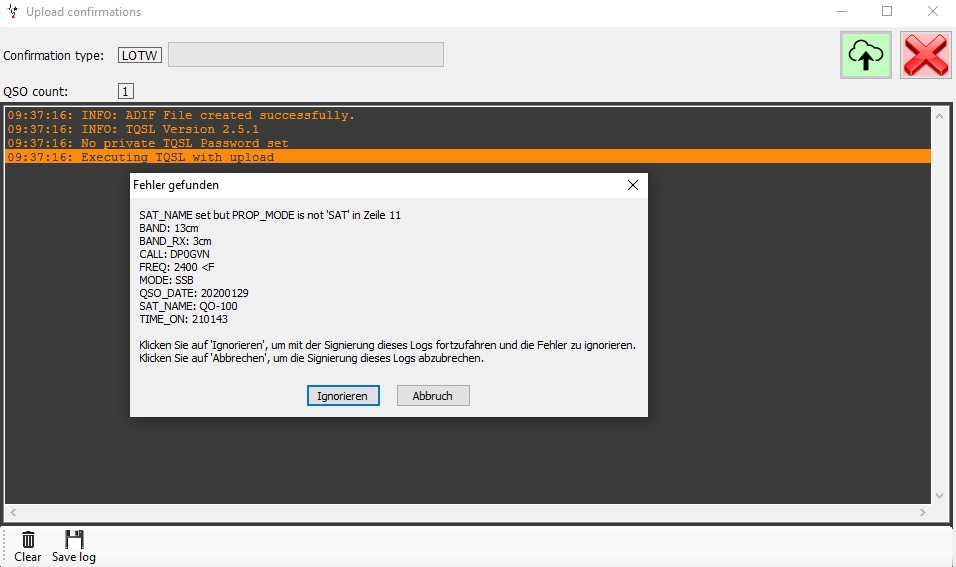

Satellite QSOs are not put up in LoTW because the "SAT NAME" is set but the "PROP MODE" is not "SAT". Now there is only the option to ignore or cancel. If I ignore this, this QSO will not be uploaded to LoTW. This happens with all SAT QSOs. Checked in LoTW, no SAT QSO uploaded
Version is 2.2.0.0
73 Gunter

Here is the upload window

Here is the information from LoTW:
Notice the difference between a DX record and a satellite record.
satellite record includes two additional lines of data :
Propagation Mode: <PROP_MODE:3>SAT
Satellite Name: <SAT_NAME:4>AO-7

I found my problem, I forgot to set the "Propagaton" in "MY Station (F4)". I had only chosen the "Satellite Mode" and the corresponding satellite. :oops:
