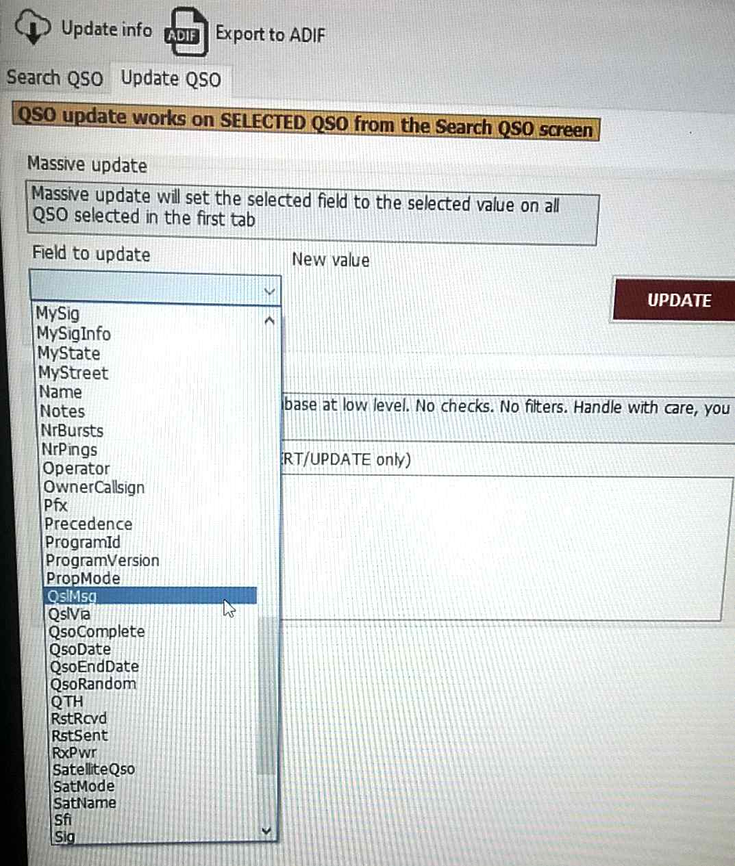

After answering my incoming paper-QSLs I like to update the QSL sent status from "queued" to "yes" (after ADIF export).
I may have missed something, but just can't find a field named "QSL sent" in the "update QSO" tab of QSO manager.
2020-01-31 19.46.54.jpg (129.59 KiB) Viewed 4196 times
73 Chris, DL4FO

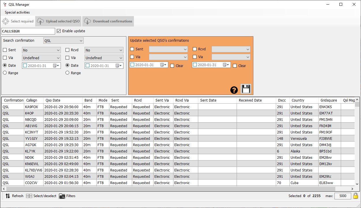

Take a look at QSL Manager for make a change as you have noted. It might work out for you.
As you can see from my screen clip I've not updated my recent calls for "QSL" cards yet either.
You can select one or two to "test" before you do an entire batch.

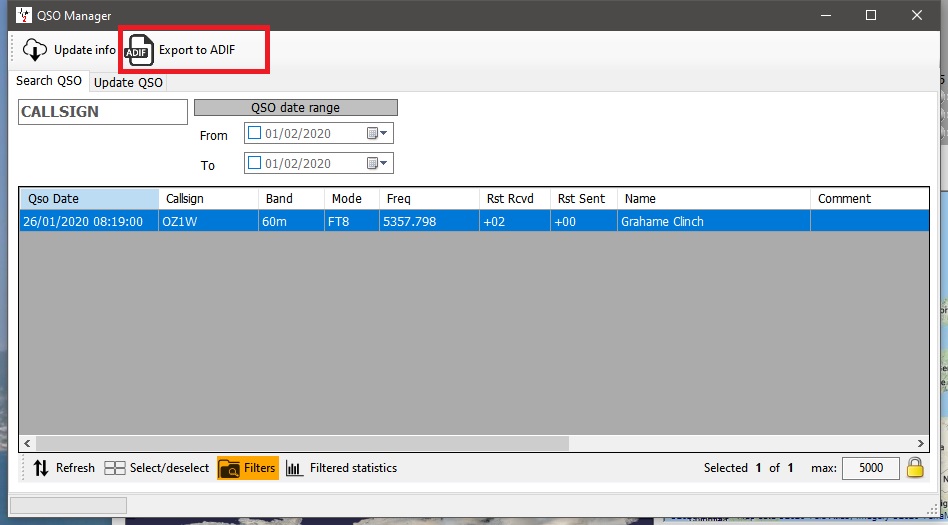

Filtering Queued and export to ADIF
In your example now go to the QSO Manager/Filters window and select the 'Confirmations' tab as below, select as shown.
When you close the filter window it will filter those 'Queued' - Now select the OQS's required for the ADIF file and click 'Export to ADIF'
Export adif.jpg (84.6 KiB) Viewed 4155 times

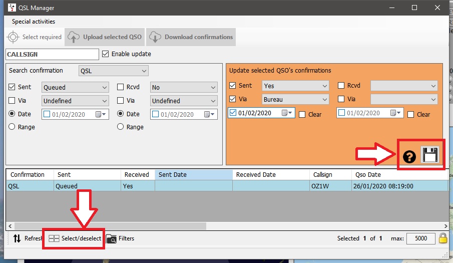

Mark Queued as Sent= Yes
Go back to the QSL Manager and select fields as in the image below then click 'Select/Deselect' at the bottom, lastly click the floppy disk 'Save' Icon to update
Job done!
