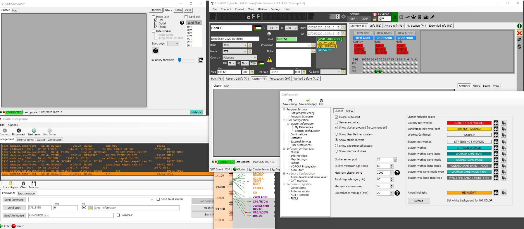

EA3IFV
Posts: 11
Joined: 16 Jan 2020, 14:31
Re: Cluster shows no info at all
Post by EA3IFV »
Hi, please find attached a screenshot in case it helps.
I have checked it all and can't find the way to fix it.
Can I enable a debug mode? Is that explain somewhere?
