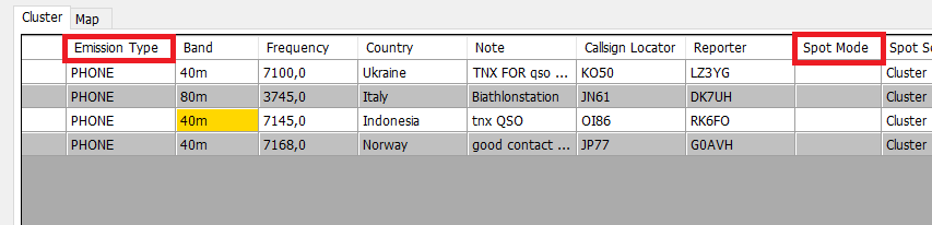

What is the line you referring to ... Is it "Spot Mode" or is it "Emission Type" ? The last one should be show
the correct one "Spot Mode" grabs from the clusters the spotted mode. By the way, CW is allowed in the
whole band ....

My question was about the field in the cluster you´re referring to. The reason is that Spot Mode is the mode who was spottetd
by the user which send this spot. Emission Type is the field you have looking for. If that field showing Phone all is correct.

I dont think there is any way a logging program can control it. It just does its best based on how its spotted and the band plan xml file in log4OM which I have edited to meet my needs a little better.
I notice it worse during contest when a given mode starts moving into what is typically different mode portions of the band.
Below is the 20m portion of the XML file.
<BandPlanRange>
<Band>20m</Band>
<Start>14000</Start>
<End>14070</End>
<EmissionType>CW</EmissionType>
</BandPlanRange>
<BandPlanRange>
<Band>20m</Band>
<Start>14070</Start>
<End>14150</End>
<EmissionType>DIGITAL</EmissionType>
</BandPlanRange>
<BandPlanRange>
<Band>20m</Band>
<Start>14150</Start>
<End>14350</End>
<EmissionType>PHONE</EmissionType>
</BandPlanRange>

So, in the example I posted I had the “phone” filter selected. Two CW stations, operating at 14.105 & 14.109, were displayed amidst the phone stations. This suggests that the band plan XML file each user is using may not be the file that is being used. In my case that would be the “291” file.
